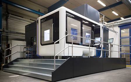

With its unrivaled precision and integrated grinding functions, the DMU 210 FD helps JB Production boost its competitive edge on the international market.
The robust rotary table of the DMU 210 FD can accommodate parts up to 1.850 mm in diameter and 5.000 kg.

The machine has a portal design for the highest precision and dynamics up to 3m/s2.
In their line of work the batch sizes are quite small, sometimes just a single piece, so there is absolutely no room for error. All the parts they are producing have to be perfectly functional in order to be profitable. This sets extremely high requirements for both the human workforce and the machine park as well. For more than 10 years JB Production has been relying on DMG MORI machines to stay ahead of the competition and set new standards in its region. Their latest investment, a DMU 210 FD universal 5-axis machining center serves exactly this purpose by enabling the company to manufacture bigger components, work more efficiently and realize even the tightest tolerances thanks to the integrated grinding functions.
With 44 kW power and 10.000 RPM on the main spindle, the machine is well equipped to cut even the hardest exotic materials.
