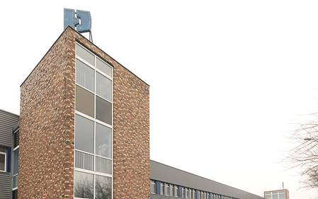

Zahnradwerk Pritzwalk is increasing its flexibility in the manufacture of complex toothed wheels thanks to gearMILL and a DMU 125 monoBLOCK from DMG MORI
Since 1969 Zahnradwerk Pritzwalk GmbH has been manufacturing toothed wheels, shafts and couplings for a multitude of different customers worldwide.
For over 45 years Zahnradwerk Pritzwalk GmbH has stood for both technical competence and high product quality as well as for a customer and solution-orientated work principle. With around 300 qualified experts the company from Brandenburg manufactures toothed wheels, shafts and couplings for a multitude of different customers worldwide from sectors such as rail transport, wind power and mechanical engineering. In order to make the production of the many different and diverse toothed wheels even more flexible, the plant installed a DMU 125 monoBLOCK from DMG MORI together with the DMG MORI gear machining software gearMILL in the year 2014.
