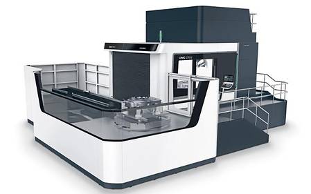

Just the number of more than 1,000 DECKEL MAHO gantry machines sold in the last 15 years is unique in the heavy machine construction industry. The new DMC 270 U from DMG MORI extends the product range in this field by a new highly productive universal machining centre. The 5-axis machine with high-stability portal design enables maximum precision at highest dynamics. A fast and space-saving pallet changer in connection with the high flexibility of the basic machine forms the basis for efficient production. Pallet loads up to 9t, setting up in parallel with production, further automation options and best possible accessibility of work area, setup station as well as maintenance facilities are additional success factors. Furthermore, peak values with regard to precision are achieved by the machine’s extremely high degree of inherent rigidity as well as constant complete machine tempering.
2.4 times more working space
Compared with the DMC 210 U, the DMC 270 U with travel distances of 2,700 x 2,700 x 1,600 mm in X / Y / Z increases these by 50% in the transverse direction and by approx. 30 % each in the longitudinal and vertical direction. The pallet size of the DMC 270 U is at 2,000 x 2,000 mm compared to 1,600 x 1,400 mm for the smaller sister model. The work area is 235% larger. The interference contours are also improved thanks to the newly designed milling head. A further advantage is that the space requirement has been kept low by appropriate design of the additional components. The maximum dimensions of workpieces are increased to a respectable 3,000 mm diameter and 1,600 mm height with a permissible workpiece weight of now 9,000 kg. These are absolutely tiptop figures in this machine class.
