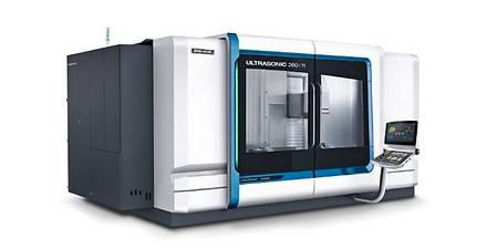

DMG MORI has equipped the DMF 260 linear and the DMF 360 linear, among others, with this path-breaking ultrasonic technology.
DMG MORI’s ULTRASONIC technology offers an economical machining option for the maintenance, repair and overhauling (MRO) of damaged fibre composite components.

DMG MORI has equipped the DMF 260 linear and the DMF 360 linear, among others, with this path-breaking ultrasonic technology. As ULTRASONIC 260 and ULTRASONIC 360 versions these models also profit from the rigidity, long-term stability and thermo-symmetric concept of the machine that ensures a high level of precision in continuous operation. DMG MORI has included the ULTRASONIC 85 with proven monoBLOCK construction in its range for the machining of smaller fibre composite parts measuring up to 700 x 700 x 500 mm. For stationary ULTRASONIC high-performance cutting DMG MORI uses the so-called technology frame – based on the gantry design of the A-axis combined with the B-axis swivel head. This allows dynamic 5-axis machining of complex workpieces such as rotor blade segments. In addition the machines are equipped with a machining area with adequate air extraction and integrated fine particulate monitoring (plus heat recirculation). The explosion-proof high-performance filter system always guarantees a stable filtering performance.

The ULTRASONIC 260 and ULTRASONIC 360 offer 5-axis-machining and profit from the rigidity, long-term stability and thermo-symmetric concept of the machine that ensures a high level of precision in continuous operation.
