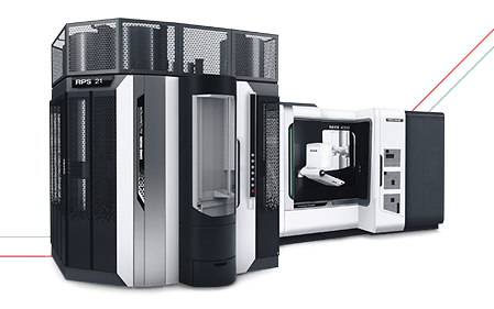

RPP (21 stations) with NHX 4000 2. Gen.
  • Space saving automation solution for single machining center with 400 or 500 square pallets
  • Prepared for unmanned operation including various options like auto coupler I/F
  • 5 pallet system with random operation, 1 setup station and pallets on 1 level (14 pallets in 2 layers and 21 pallets in 3 layers available)
  • Easy operation using machine controller of HMC with self-explaining Pallet Manager software
Technical data
RPP 5/14/21 for
NHX 4000 2nd
NHX 5000 2nd ​​​​​​​
NHX 5500
Maximum workpiece weight
kg400500 kg option: 700 kg
700
Maximum pallet/workpiece size (5/14 ) / (21) pallets
mm
Ø630x
H900 / 700
Ø800x
H1000 / 700
Ø800x
H1100 / 700
Capacity
Maximum number of stations
pallets
5/14/21
5/14/21
5/14/21
