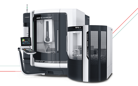

Machine integrated automation for smallest foot prints
DMC 65 monoBLOCK with RS 3
  • Handling of workpieces up to ø 3,400 mm, a lenth of 1,650 m and a weight up to 10,000 kg
  • Reduction of auxiliary process time through loading and unloading during machining
  • Manless shifts for recurring workpieces through ring buffer with max. 12 pallets in the system
Rotary Pallet Storage with outstanding space saving and setup capacity
RPP (21 stations) with NHX 4000 2. Gen.
  • Handling of workpieces up to ø 800 mm, a lenth of 1,100 mm and a weight up to 700 kg
  • Space saving automation solution for one machining center with 400 or 500 square pallets
  • Prepared for unmanned operation including various options like auto coupler I / F
  • 5 pallet system with random operation, 1 setup station and pallets on 1 level (14 pallets in 2 layers and 21 pallets in 3 layers available)
  • Easy operation using machine controller of machine center with self-explaining Pallet
  • Manager software
