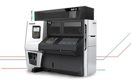

SR-1C with G100
  • Compact, space saving with built-in loader
  • Combinable with various kinds of automatic peripheral equipment (washing, measuring marking etc.) and loader hands available by flexible design
  • Loader status monitoring can be delivered by DMG MORI messenger
