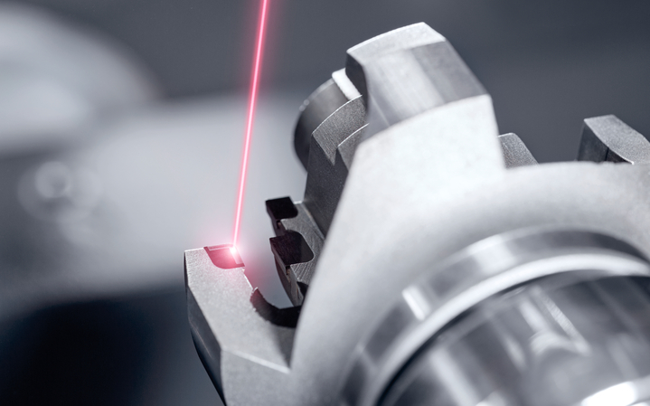

The DMG MORI LASERTEC 20 PrecisionTool produces sharp cutting edges under 1 µm.
DMG MORI offers advanced finishing of cutting edges with the LASERTEC 20 PrecisionTool. The 5-axis laser machine rounds cutting edges without any post-processing in a single clamping at a speed of up to 5 mm/min with 1.6 mm thick PCD. It is also possible to measure the stroke profile of the round laser chamfer and to customize or adjust it on the machine. The LASERTEC 20 PrecisionTool produces cutting edges with a sharpness of less than 1 µm and a defined cutting edge rounding of 3 µm, 6 µm, 9 µm, and 15 µm. Negative chamfers are also possible. In addition, the process-reliable laser processing contributes to higher cost-effectiveness because it increases the service life of the tools by a factor of 2.5.
