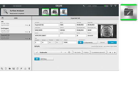

JOB MANAGER
JOB MANAGER
NEW // Dire Direct import of orders from own MES and ERP systems into CELOS
With the new job import function of JOB MANAGER you can take over orders directly from the existing MES & ERP in CELOS. Order data no longer has to be transferred manually from the MES system to CELOS because automatic data exchange from the MES to CELOS can be set up.
This makes it easier to create, process and archive orders on several machines.
