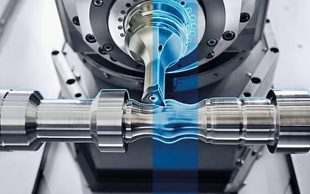

FreeTurn
  • For shop-floor programming with easier integration in the NC-program.
  • Easy tool definition in for the NC-program due to the integrated tool library
  • Possibility to define the adjusting angle (kappa) for each cutting edge and each operation to achieve the best machining results
Customer Benefits
  • Possible saving of different tools and related tool changing time
  • For roughing and finishing, profile turning, external cylindrical and face turning operations with optimized cutting force direction
Left: Easy selection of the FreeTurn Tool via integrated library / Right: Easy tool definition for shop-floor programming on the machine
