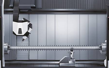

Large Build Area
  • Up to 1,040 mm on the X-axis, -280 mm to +330 mm on the Y-axis, 3,890 mm on the Z-axis
  • Largest workpiece size: Φ1,010 mm × 3,702 mm
  • Suited for large workpieces including rocket engine parts for the aerospace industry, oil-well pipes for the energy industry and shafts for transport aircrafts
Hybrid of metal additive manufacturing technology and subtractive machining
  • Efficient  additive manufacturing and subtractive manufacturing on one machine with the linear axes (X-, Y-, and Z-axis), B-axis (turn-mill spindle), C-axis (Left spindle and Right spindle)
  • Synchronized operation of Left spindle and Right spindle that transfers workpieces between the two spindles to achieve streamlined additive manufacturing processes
  • Turn-Mill spindle equipped with the AM head and AM nozzle to carry out metal powder injection and laser irradiation simultaneously
  • Laser output - 2,000 W(standard), <4,000/6,000/8,000 W(option)>
Extensive maintenance functions
  • Movable and high-performance dust collection duct to prevent dust powder from scattering
  • Zero Sludge Coolant Tank that effectively collects fine sludge inside the coolant tank as standard
  • Laser sensor installed on the machine cover and window to detect laser before it penetrates the cover and stop it
