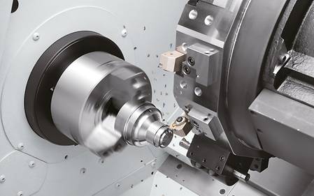

Cutting-edge technology for high rigidity and high accuracy
- Latest in-house made DDS (Direct Drive Spindle) turnMASTER
- Slideways on the X-axis for higher damping performance, and linear motion guides on the Y- and Z-axis for improved positioning accuracy
- Full closed loop control (Scale feedback) SmartSCALE as an option: Enhanced positioning accuracy
High-quality, High-performance Spindle turnMASTER
- 3-year guarantee on the reliable turnMASTER
- Our in-house manufactured built-in motor spindle, with DMG MORI’s long years of technological know-how, demonstrates overwhelming excellence in heavy-duty cutting that requires rigidity
- The labyrinth structure has been enhanced, taking into account frequent use of high-pressure coolant
- Prevent coolant entry and improve spindle durability
