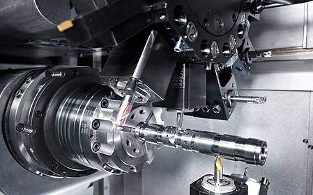

SPRINT 65
4-axis production turning with 3 Y-axes, B-axis and 3 turrets for up to 36 driven tools for max diameter 95mm
Automatic turning with both collet and chuck application
- Main spindle with 5,000 rpm, 150 Nm, 22 kW (nominal)
- Counter spindle with 5,000 rpm, 86 Nm, 18 kW (nominal)
- SIEMENS models are 2 turrets twin concept, 3 turrets and 3 turrets plus B-axis
- FANUC model is 3 turrets
Up to 36 tool stations
- Total of 12 VDI 30 tool stations with Trifix per turret, each can be driven.
- Driven tools spindles up to 12,000 rpm, 12 Nm, 6.5 kW (nominal)
- B axis with torque motor and direct measure system
FANUC and SIEMENS ERGOline Full-HD touchscreen 21,5” with CELOS
- CELOS APPs facilitate the consistent management, documentation and visualization of order, process and machine data
- Up to 10 linear axes, 1 B-axis and 2 C-axes
- Fanuc version with MAPPS V
Highly dynamic drivers in all axes for fast machining and minimal idle time
- 100% production-optimised design
- Free chip fall due to vertical machine bed, no temperature influence
- Thermostable and self rigid machine bed with 3-point-support
- Machining of longer workpieces with two turrets and the patented TWIN design
- Highest accuracy due to water cooled main and counter spindle
- Tool Management System
- 21,5” multitouch screen
- Achievable quality ≤ DIN 7
- Use of regrinded tools
