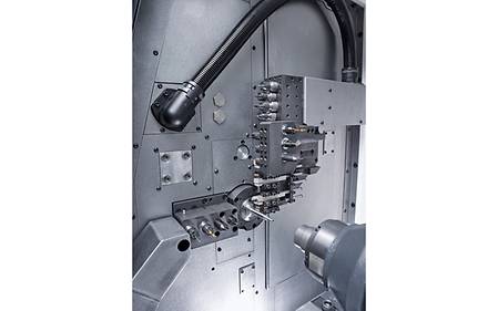

 Sprint 20|5 by DMG MORI
Automatic turning with 5 linear axes and up to 2 C-axes
  • Main spindle  with 10,000 rpm, 14 Nm, 2.2 kW (nominal)
  • Counter spindle with 10,000 rpm, 4.8 Nm, 1.5 kW (nominal)
  • SWISSTYPEkit optional for short and long part turning on one machine
Total of 23 tool stations
  • Up to 6 driven tool stations, 4 driven tool stations as standard, 2 driven stations for back-working optional
  • Driven tools spindles 6,000 rpm, 1.43 Nm, 0.9 kW (nominal)
Control panel with 10.4" colour display and FANUC 32i
  • 2 control channels, 5 linear axes and up to 2 C-axes
  • Tool Monitoring System with graphical tool load display as option
  • Up to 2 tools working simultaneously
Highest rigidity and accuracy
  • Constant stiffness due to large ball guide ways with balanced distance
  • Vertical covers and free chip fall
  • Integrated spindle motors for main and counter spindle with direct measuring systems
  • Thermo-symmetric machine bed  design for highest accuracy
