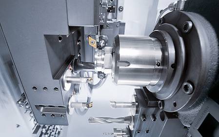

SPRINT 42 linear by DMG MORI
Automatic turning with 6 linear axes and 2 C-axes
  • Main spindle  with 6,500 rpm, 37,5 Nm, 5.5 kW
  • Counter spindle with 6,500 rpm, 19.6 Nm, 3.7 kW
Total of 26 tool stations
  • Up to 11 driven tools, 8 driven tool stations as standard, 3 driven frontal station
  • Driven tools spindles 5000 rpm, 3 Nm, 1.9 kW
  • Linear drive in X1 with 1 g acceleration for fastest dynamic and accuracy
DMG SLIMline featuring a 15" screen with FANUC 310i
  • 2 control channels, 6 linear axes and 2 C-axes
  • Tool Monitoring System with graphical tool load display as option
  • Up to 2 tools working simultaneously
Highest rigidity and accuracy
  • Constant stiffness due to large ball guide ways with balanced distance
  • Vertical covers and free chip fall
  • Integrated spindle motors for main and counter spindle with direct measuring systems
  • Thermo-symmetric machine bed  design for highest accuracy
