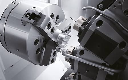

Process integration
  • Largest number of tools in the class: 18 tools
  • Integrated machining in the smallest floor space
  • Proven experience in diverse machining, from round to irregular workpieces
Super-high precision
  • Thermal displacement (at cold start): ø 4.0 μm Circularity: 0.8 μm
  • Adoption of a pre-tension structure suppresses thermal displacement and realizes high positioning accuracy
  • Stable machining accuracy thanks to stainless steel covers
High rigidity
  • The horizontal, single-piece, scraped cast iron slideways with superior damping performance and a high resistance to chatter facilitate stable machining
  • Minimized distance between the axis travel reference guide and spindle restricts effects of generated heat
Expandability
  • Versatile system variations to accommodate diverse production needs
  • A wealth of highly practical applications and peripheral devices available
Max. turning diameter
240 mm
Max. work piece length
245 mm
Max. chuck size
8 mm
Max. bar capacity diameter
67 mm
Axes
Max. number of axes
5
Max. number of linear axes
3
Max. number of Y-axes
1
Max number of C-axes
1
Main spindle
4,000 rpm
Drive power rating (100% DC)
7.5 kW (AC)
Torque (100% DC)
58 Nm
Tool carrier
Max. number of tool carriers
2
Max. number of tool pockets
15
10 / 10000 rpm
3.7 kW (AC)
Torque (100% DC)
6 Nm
Machine Size
Machine weight
2,400 kg
3.3 sqm
