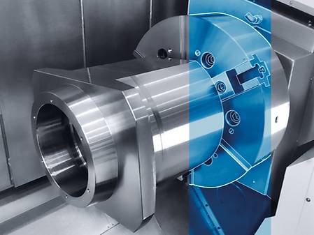

- Left spindle up to 3,250 rpm and 1,975 Nm
- Right spindle: ISM 80 with 4,000 rpm and max. 360 Nm, or ISM 102 with 3,250 rpm and max. 770 Nm optional
- Bar machining up to Ø 127 mm
