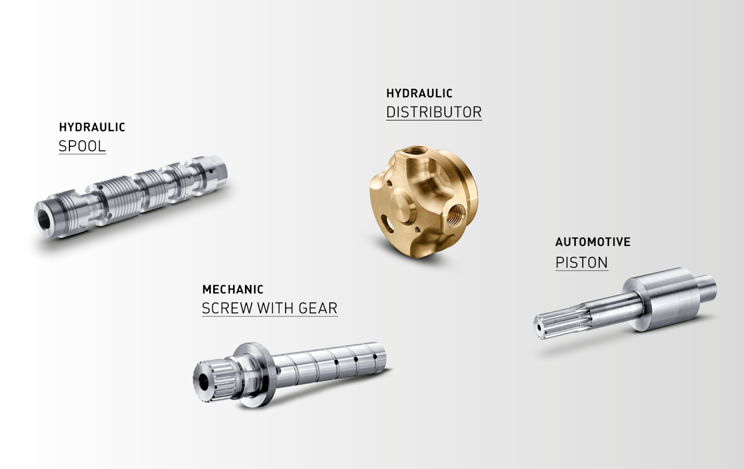

The NZ platform allows efficient machining of turning parts for industries like hydraulics, engineering and automotive.
